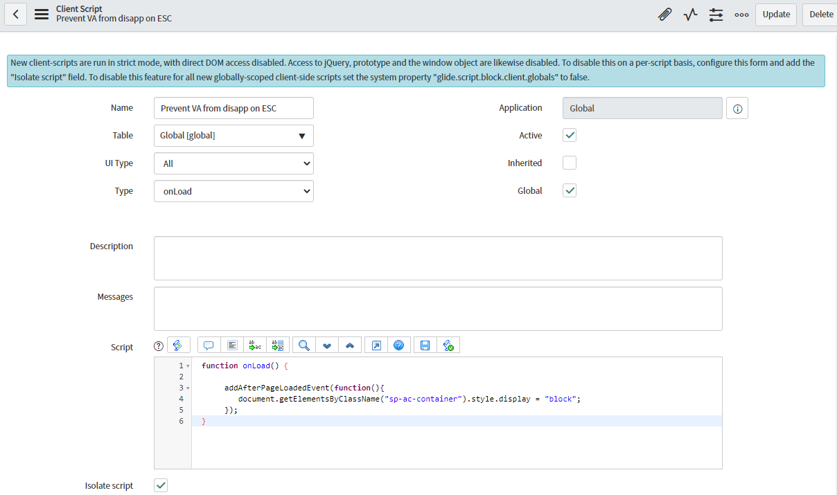

Hi Logan,
Thanks, this should really be the way but it seems the script is not triggered; I created a global client script on the Global table or without a table but the DIV style is not touched.
I even tried this way as in theory getElementsByClassName returns a nodelist object: document.getElementsByClassName("sp-ac-container")[0].style.display = "block";
But no luck. (I even added alerts to see if it runs but did not receive any.)
I also tried to find where the class sp-ac-container is manipulated but found no client script or UI action containing that...
Karoly
