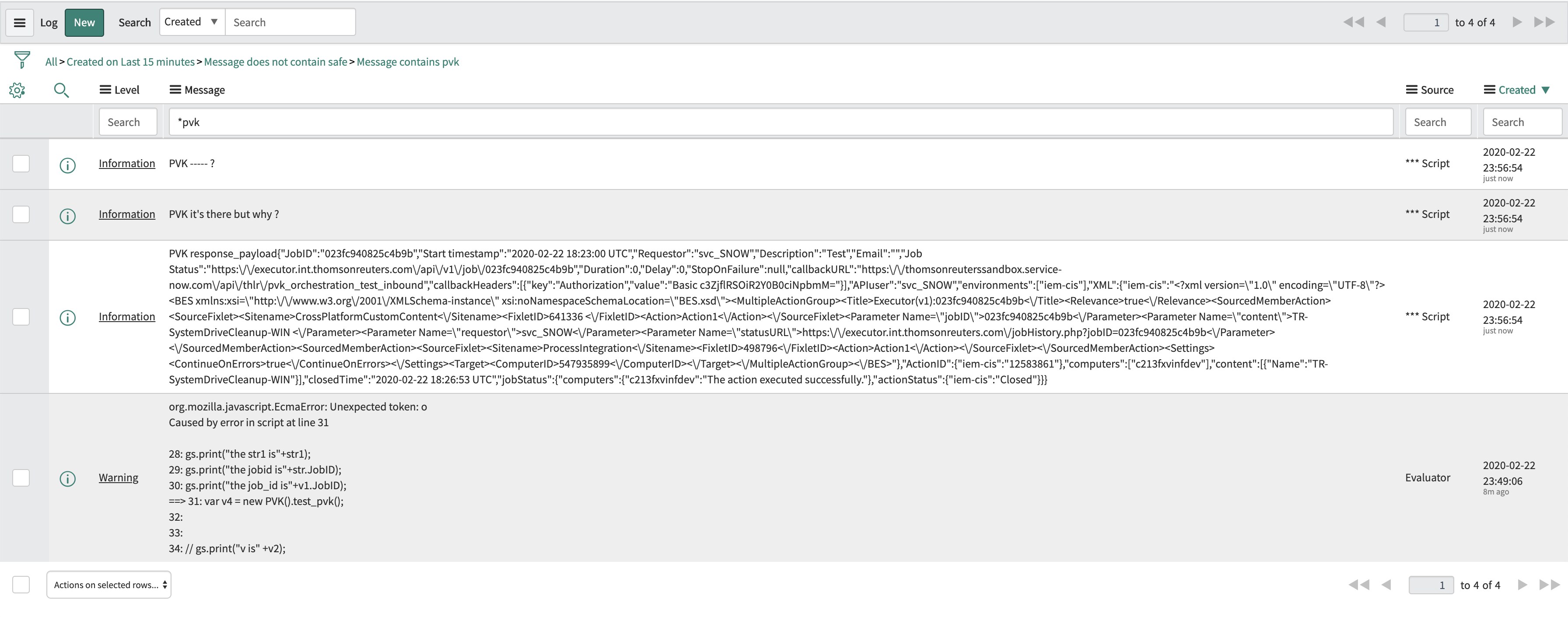

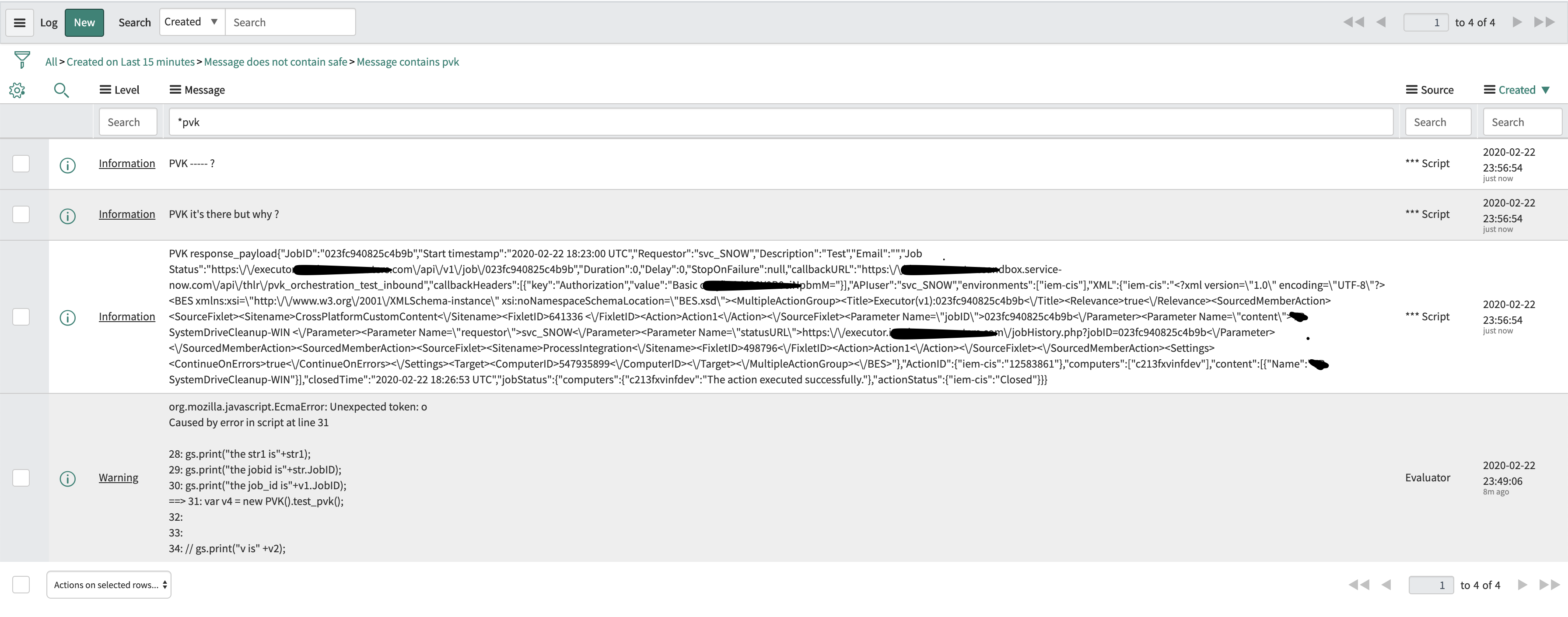

We have a scripted rest API post method which gets a request from another API, based on the request we get we have to do some validation (I used a script include by calling it from scripted rest api & tried to update some fields in a table.) but it's not working. it's not working when i tried to do the same thing by declaring the variables it's working fine.
Scripted Rest API : find_real_file.png
POST method
Script Include
Logs
Table
I was wondering why the values are not being set on the table even the script is written correct. to check if the script works at all .... created a sampletest_pvk function . The same thing works i.e. values are set (from test_pvk function) .Could anyone help on this please

Hi, not sure if I have fully understood but in line 7 of your script include you are encoding response_payload, perhaps this should be decode?
