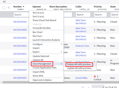

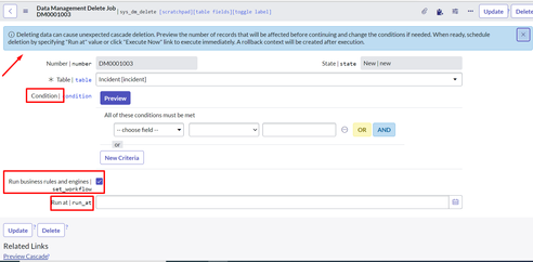

1. Use Data Management option present in list view to delete multiple records with preview. It will allow you to select a condition for what all records you want to delete, and do you want to run the Business rules upon deletion or not. You can even select 'run at' in this option.
