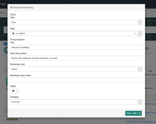

When a widget is added from the page editor. There is pencil icon, which opens a modal allowing you to set various options for a widget. Do those options come from the options schema or data table?
Please clarify what is the use of data table and options schema.

The modal that opens in page designer points to the options schema, specifically the widget instance's schema. Option schema allows a widget creator to define configurational behaviour that can be altered on a per-instance basis.
For data table, could you share further on where you're seeing this? There's a few overlapping uses of the term 'data table'
Here is the Data Table field.

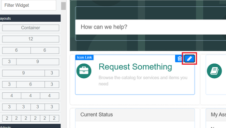

  • I believe you are referring to the pencil icon for widget in page designer as pointed in my screenshot.
  • The form appears are the instance of a widget.
  • You can find all the instance in related list of that particular widget.
  • You can also open the instance options from portal to get access of the Instance form.
