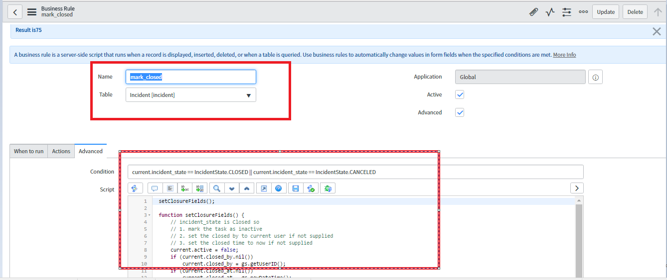

If it's not working you need to check your Business Rule as well named "mark_closed" on the Incident Table available OOB to check if it has been modified or not because with the help of this BR only the Flag gets set to False for Closed and Cancelled States as shown below:
You may also Navigate to the BR using the below link:
https://instance.service-now.com/sys_script.do?sys_id=bf3f8917c0a8016400a867dc0794e8ad&sysparm_recor...
Replace "instance" with your Instance Name to check for the BR.
Hope this helps.Mark the answer as correct/helpful based on impact.
