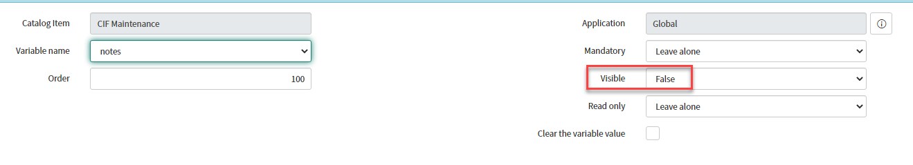

‎09-16-2020 11:07 PM
What steps do you take if you want a checkbox variable to be available to the agent performing catalog task, but not on the form request itself?
‎04-22-2021 08:27 AM
Hello Treva,
Did you get any solution for this? I'm looking for the same thing
‎06-11-2021 01:22 PM
If you want to hide a catalog variable from the portal, but have it available for the agent on the fulfillment side, you will need to hide the variable using a Catalog UI Policy. Make sure the policy only applies to the Catalog Item view. After that, set the visibility of the variables you want to "false", you do not need to specify a condition for the rule to apply.
