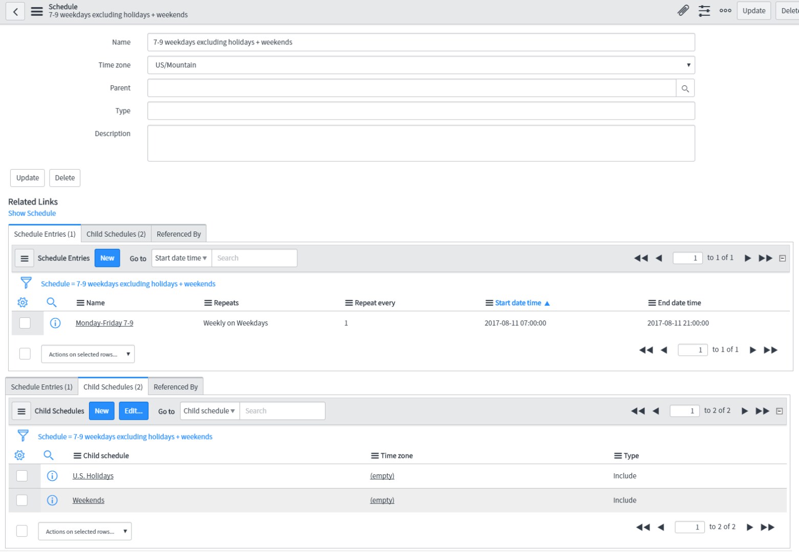

My Scheduling seems to look ok . . .

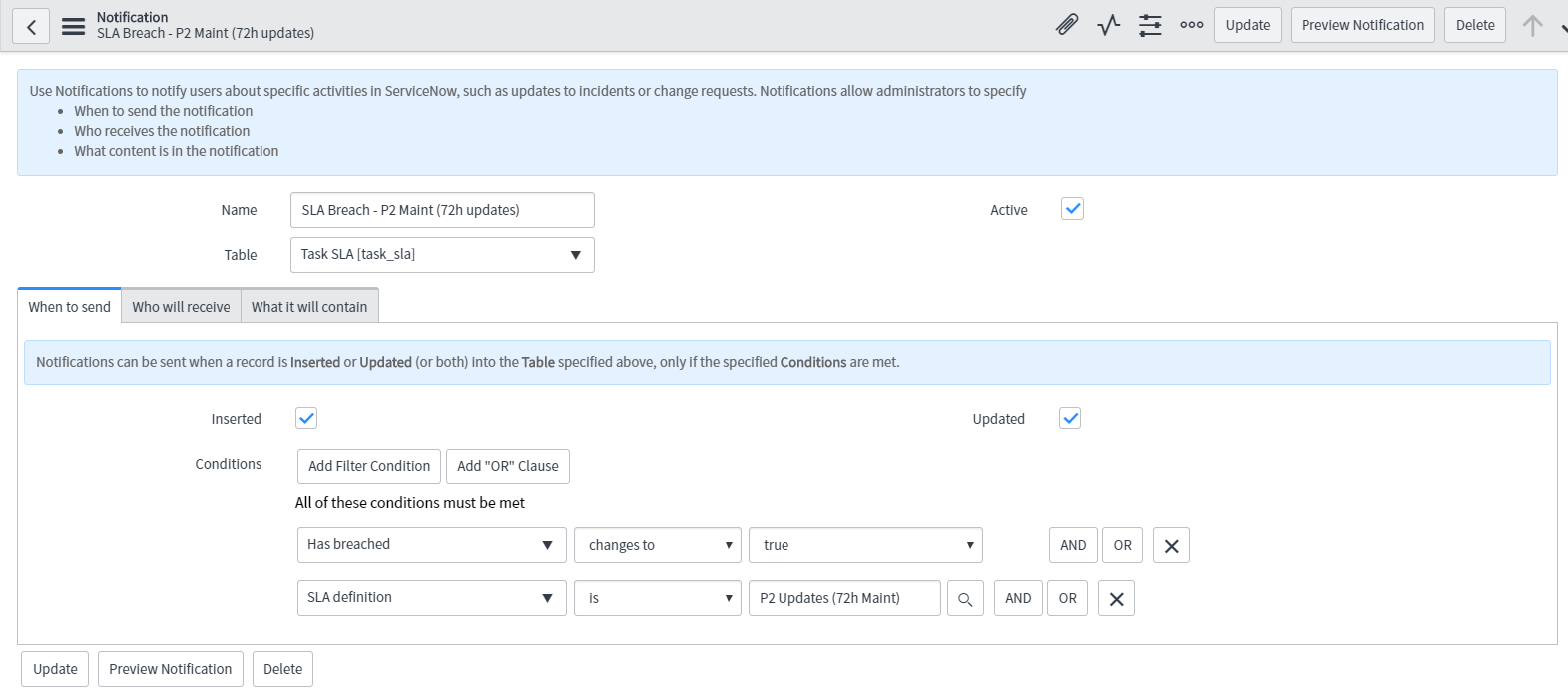

The original NOTIFICATION I had setup didn't work . . .
Where I set Event is Fired for sla.warning.breach using the SLA above.
So this never fired so i retried . . .
... i retried using this setup:
Has Breached changes to True
It fired an email, but not when I was expecting it.
This fired an email notification but I wasn't expecting it outside the 7am-9pm Weekdays ONLY.
This one fired at 10:09pm on a weekend . . .
Any ideas what I am missing/doing wrong?
