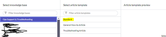

I am not able edit the KB filed after article is published though I have admin access. The article is created using standard template of knowledge base. I am able to edit the kb field for the remaining article templates when the article is in published state. If this is an OOB behavior, then where can I find the configuration of the standard template as this template is not available in article template table. please see the attached image of the article is in published state and created using the standard template of kb.

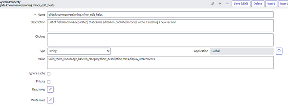

Let me explain the requirement clearly. I am testing out this property and SS i attached.
when i am testing out this property its working fine for the templates apart from "standard" template and I am able to edit the KB field when the article is in published state without creating any version of the same.
In the SS I am able to edit the KB field when the article is in published state without checking out it and without using the edit button because I have the admin access i am able to override.
But when I am creating the article using "standard" template like I am unable to the same. Not able to edit he KB field when the article is in published state.
if you see here, though I have admin access I am unable to edit the KB field for the above article when it is published state when I am creating an article using "standard" template.
