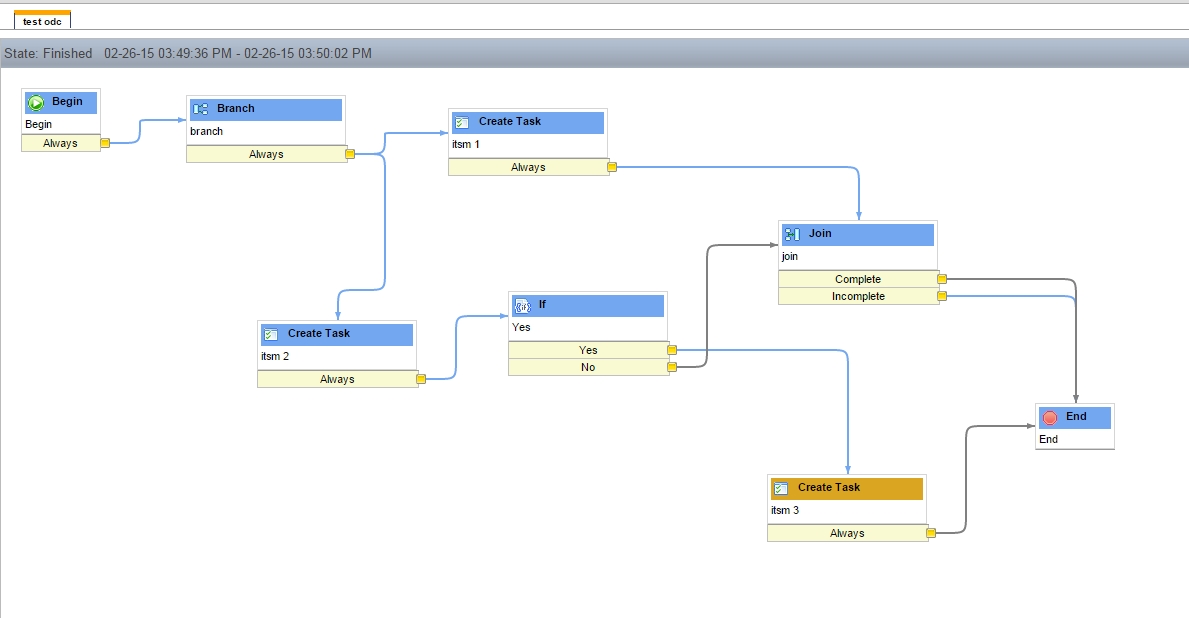

You can make it go down the incomplete path from a join, but in practice I've never needed to do it.   The trick is to have some sort of fork before the join that can skip it.   I've attached a screenshot of a test workflow I just made to show you what it looks like. The incomplete path executes if the join gets skipped from what I understand, rather than any sort of task state value.

@acretion  - Thanks much for the explanation. Just embedding your attachment for easy ref and to avoid file download.
