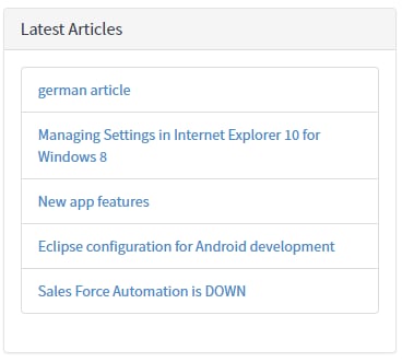

In the portal, I have set the limit to display only 5 articles which are as below.
Hope that will help you to solve the issue otherwise, I have tested widget in the different environment too and it works fine.
