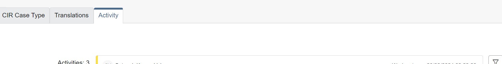

The result will look like this:
And for anyone with additional write rights it will look like this:
