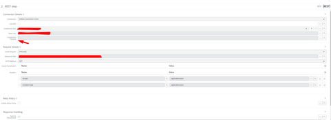

We are working on integration with WD to pull employees information, using the Report as a Service (RaaS)
In flow designer, we are using REST step to pull JSON file with all the information.
the REST call is configured to save the response as attachment (then using import set to load the data to relevant tables)
From time to time, we are getting execution socket timeout error. when it happen, we can see that the flow runtime is about ~3 minutes (~175,000ML). the file size is ~36,700 KB
After checking with Workday team, the timeout is not coming from WD - it seems like we are getting the timeout from ServiceNow side.
We do have the property glide.http.outbound.max_timeout.enabled set to false, and on the Rest step, we have not defined timeout parament
We can see that when the process work, the runtime is below 170,000 ML, and when it fails it above 175,000
Any idea how to resolve this?
Thanks!
