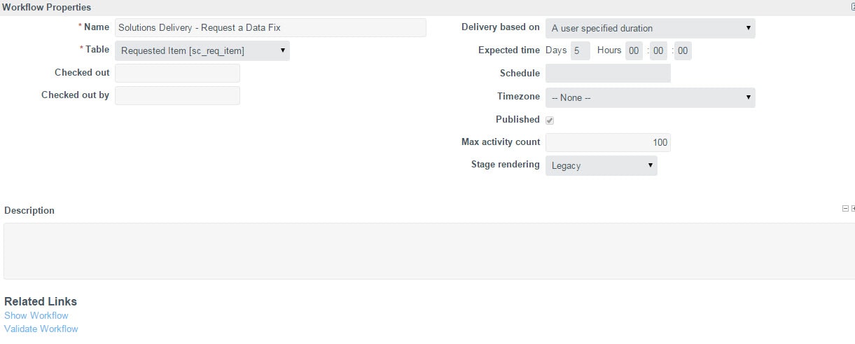

I'd suggest looking into the Workflow Properties. Make sure it is Published, running on the right table, and if there is a Condition met, that it is being matched.
Thanks for the reply. I didn't think that the workflow needed to be published for it to fire, but I made sure it was anyways. It is running on the sc_req_item table, but where do I confirm that the catalog item is set to create on the requested item table?

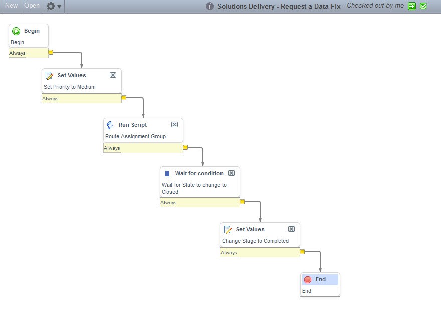

It's a fairly simple workflow:
