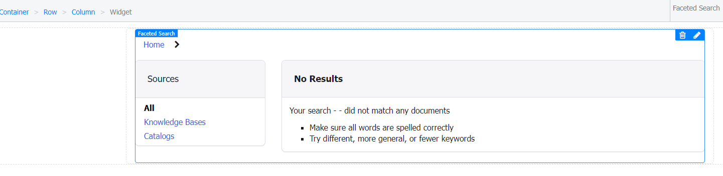

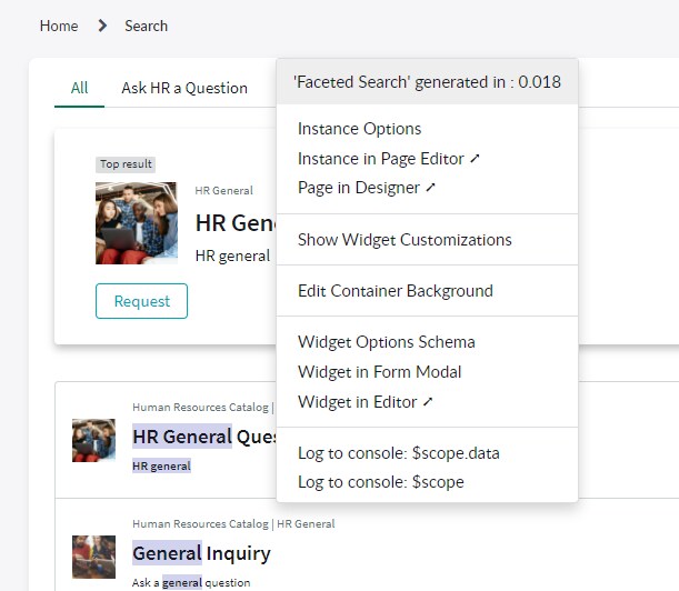

Okay got it! We are using those widgets on the knowledge page. However, I think with the initial search now being used by the AI Search Assistance, it takes the addition faceted portion away. Because I believe one of the main purposes of the AI Search is to help the user now have to comb through categories, etc. The AI will grow and learn what the user is looking for and provide the best results based on their search.
That is my take on it - reason being is, once I enabled the AI Search and configured my search widgets to use it, there are no more additional faceted boxes within the Faceted Search which is OOTB.
Here is what it looks like without the AI Search being enabled and used both from Page Designer and Portal Facing:
And that is without any modification - just OOTB.
Now with AI enabled and being used for my portal (I did not modify this widget):
Now, this is just my thought process here. The screen shots showing the additional faceted boxes for filters is from my personal dev instance with AI disabled. And that was how our company page looked as well (OOTB) with that widget. Now that we are upgrading to the employee center pro and I have enabled AI Search and pointed my searching to it, those additional filters went away. I did not personally do it (since we cannot do it anyway as the Faceted Search widget is Read-Only policy).
I am actually in the process of now testing this theory with my personal dev - just waiting for the AI status to become enabled.
But for knowledge page, all those additional filters should be there for you.
Hope this shed more light on this topic. Let me know if this helps, and, if your knowledge page is all set with the filters. That should still be normal.
