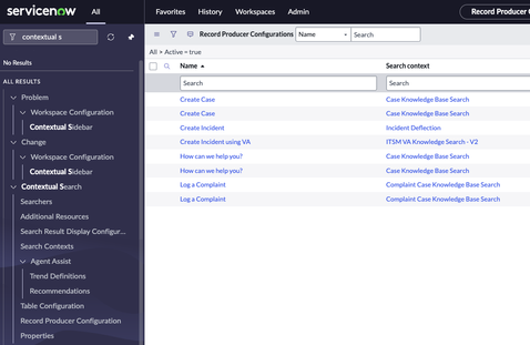

hmm, I guess I've only ever done it on record producers. You have to map the catalog item to the search context which you can do via the "Record producer configuration" menu item. However, it appears that the field on that form is locked down to just record producers. I've linked an article which discusses how to open it up to both RPs and catalog items

Contextual search is the product that is available for us customers, assume SN use this too but they do have some fun custom things on the HI portal.
If you've got the OOB demo data loaded in your instance, the provided "Create incident" catalog item has the context search widget added which is the presentation layer that will show related articles, and items to a user

Can I maybe get some additional hints how to get it running from a Catalog Item? I see it works fine on the Create Incident RP, so I simply added both Custom type variables (including the Macro/Widget settings) into a test Catalog Item. But when I type some words into the multiline variable which I also added, still nothing happens. I tested with exactly the same search terms in both forms.
Does it maybe only work on Record Producers, or might I have forgotten anything?
10-30-2024 09:11 AM
