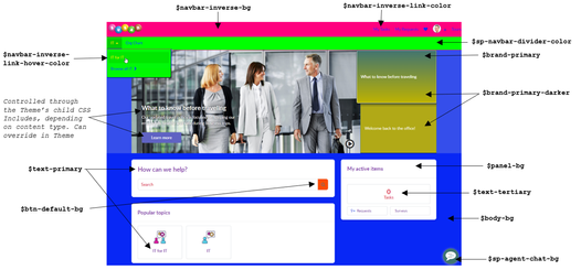

You can change the ESC from here. You will need to first make sure you are in the correct application scope. Do you know how to do this? If you changed it after opening the Branding Editor, you will need to refresh that screen. I put Employee Center Pro in the first reply as the application scope example, but normally the OOB Employee Center is in the Employee Center Core scope. Depending on the release you are on, you may get some red error pop-ups when you select the EC portal from the drop-down. You can just close those.
If you are more familiar with CSS, you can update the Theme on the EC portal record. Below are some images to help you know which properties go with what.
Topic Page:
