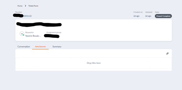

I discovered that we can still add attachment via this standard tab (attachment) even if the case is closed:
I tried the onLoad client script with disableAttachments() function, but it didn't work.
Do you have a solution to avoid adding attachment for closed cases?
