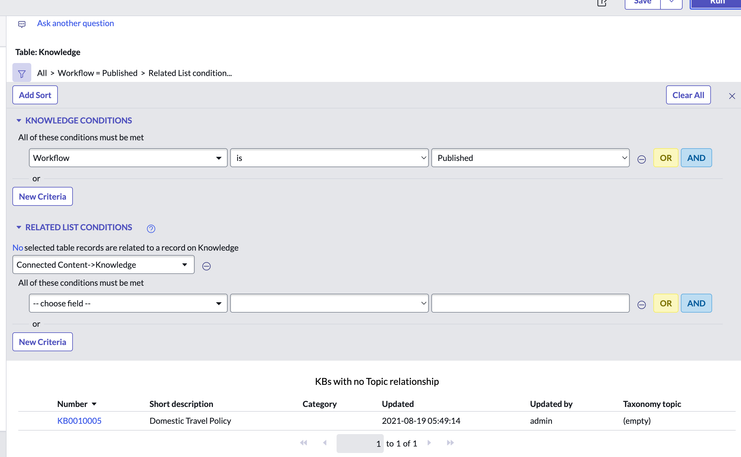

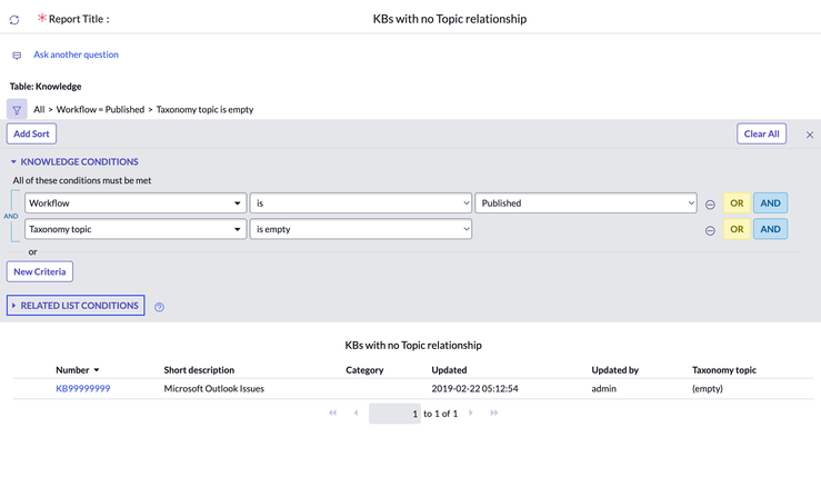

I think that you're looking for something like this:
OR
Either of these should work. Just like Dan mentioned.
