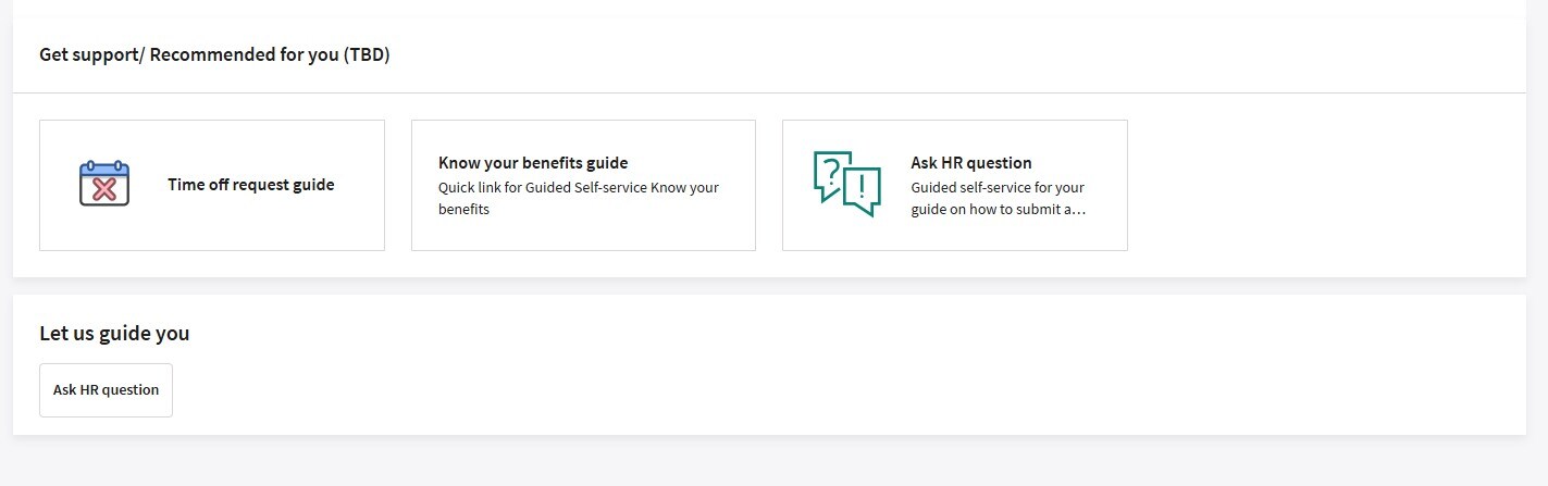

09-16-2025 04:55 AM
Thank you for your quick feedback!
I have read the documents but still not sure which is the right widget to use?
1. Widget Quick links: It appears in the topic page with the icon but nothing happens when I click on it
2. Widget guided self-service processes for topics: It is now appearing in the topic page. But how can I add the icon and description to it? (widget below)

09-17-2025 04:48 AM
Hello @miftikhar20 ,
in the video you can see that they have the guided self-service in the quicklinks widget with a picture. Also in my attached picture you can see that I have also add an icon. It is possible to add a picture/icon to quicklinks OOTB.
The only thing for me is that it will not trigger the flow when I click on the quick link widget from the Portal.
Only the widget Guided Self-Service Processes for Topics seems to trigger the flow for me.
