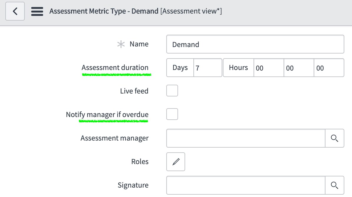

Out of the box, there is an easier way to configure assessment durations in recent ServiceNow version. If you go to "Assessments > Metric Definition > Types" you'll find that there is an Assessment duration field and a Notify manager if overdue flag.
