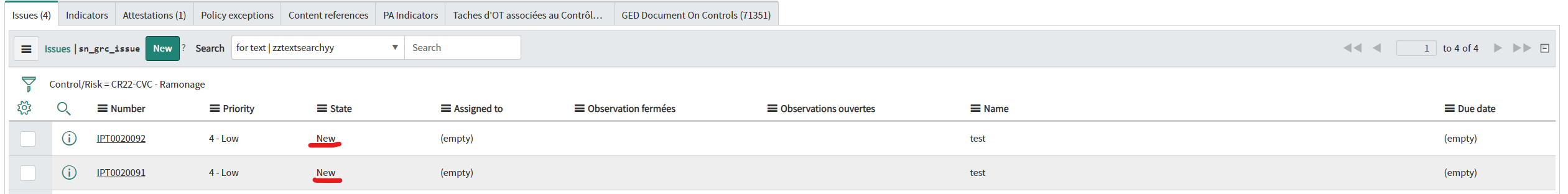

How can I change the control status to "Compliant" after closing all isues associated with the control.
How it Works Today:  it changes the status of the control to "Compliant" When closing just one issue
Control:
Issues associated with the control:
