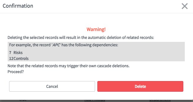

Next you want to go to the All Profiles modules and delete (yes, hard delete all the profiles). I would do this in small batches - because there is a lot of processing that is going to happen when you do this. I just deleted 3 profiles from my test system from the list view - and I got this pop-up message:
So, what it is going to do is go and retire these 7 risks and 12 controls. That is what will happen on your system.
