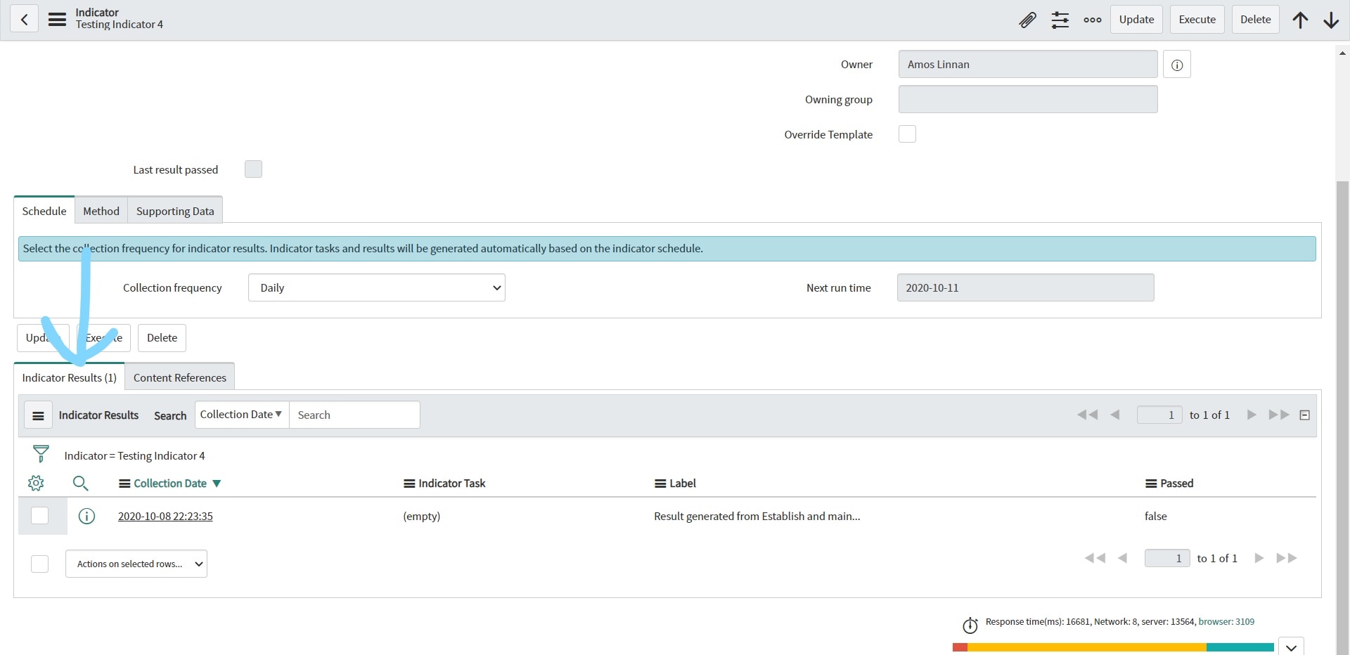

How to get details of Risk\Control tasks in Indicators. Example with Risk, it has details like State, Owner, Description, Additional Information etc. How to get those values in Indicators with tab "Method" set to "Script".
In the figure given, Demo 13 is a Risk type file.
Script retrieving the Demo 13 details(State, Description) into Indicators "Test 6" is needed.

No Naveen, I couldn't see the values of Name, State in Indicator record. Actually my query is, whenever an Indicator Result is generated for an Indicator there's a field called "Value". Name, State & Description values of desired Risk file should be available in "Value" field of Indicator Result record of that particular Indicator record.
How to complete the task using "Script" in "Method" tab.
