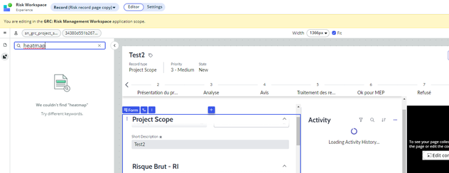

Hello everyone,
On the Risk Workspace, I'm trying to use the Component called "Risk heatmap" that is used on the "Heatmap workbench" on another page.
This is the component that I'm trying to get. This exact component is also used on the "Operational risk manager home page grid" variant of the "Home" page of the Risk Workspace.
The problem is, when I search for the component, I can't find it.
I've found the component record "sys_ux_macroponent.do?sys_id=5615fd70af6959fc63ae0ad8a84223e0" but don't know how to actually use it on the UI Builder.
Any idea on how to use the Risk heatmap on another page ?
Best regards,
Aly
Naveen Kumar4
Meanwhile,
to get that component to UIB you can turn off internal component flag on the below URL
now/nav/ui/classic/params/target/sys_uib_toolbox_component.do%3Fsys_id%3D88e25d28ae66d26cfaad64556a049063%26sysparm_record_target%3Dsys_uib_toolbox_component%26sysparm_record_row%3D1%26sysparm_record_rows%3D1%26sysparm_record_list%3Dsys_scope.nameCONTAINSheatmap%255EORDERBYorder

Hello @Naveen Kumar4 ,
Yes, I've found this KB article while researching but I can't access it.
I was going to open a Case on Hi Support.
Are you able to provide me the access to this article ? It would be much appreciated.
Best regards,
Aly
