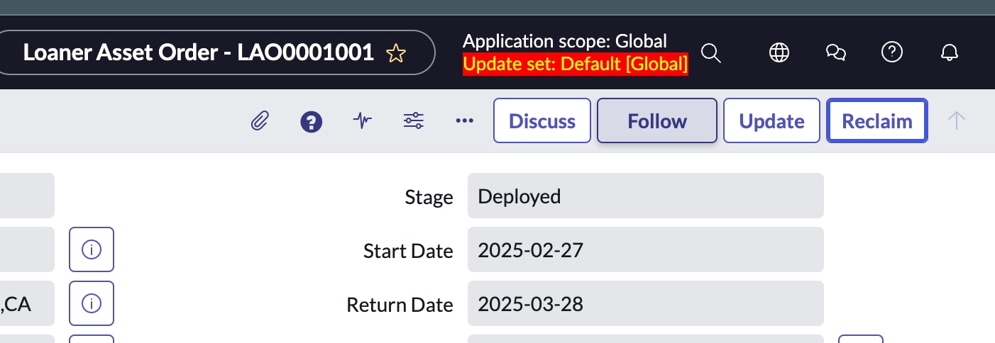

Immediately after completing the second task of the loaner process (Deploy) the Loaner Asset Order form displays a UI Action button at the top called 'Reclaim'. If you select Reclaim it asks you to input everything that the third task (Reclaim task) asks for. Once you select OK it updates the asset and auto creates the Reclaim task, populates the task with your selections, and then immediately closes it out. I have included some screenshots of what this process looks like.
