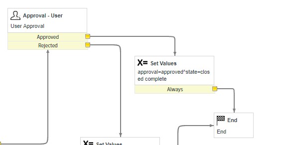

In my case I have created a workflow for the Custom HR service. I have set the state to Close Complete after approval=approved. But the state is changing to Awaiting Acceptance after update. I don't want the user acceptance. How to deactivate that and if we deactivate what could be the impact.

Hi SMORA,
The OOB HR Service configuration offers Case Options to not have the case go to Awaiting Acceptance. This can be configured for the HR Service by selecting the "Skip Automatic User Acceptance State" as seen below. This is configured for each HR Service, so you have flexibility on which HR Services will use this Case Option.
This is another great OOB feature you can leverage for your use case. Let us know if this addressed your issue.
Mike
