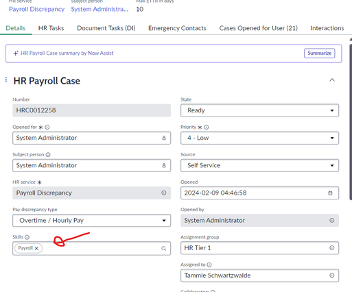

Hi there,
Im facing a weird issue in the DemoHub environment. In the environment the Skill determination business rule is switch off, as well the Skill determination rule for the particular COE table. One of a way, ServiceNow still assign a skill to a HR Service once it have been submitted. Example the payroll skill for the example service Payroll discrepancy.
Anyone has an idea what is causing this?

@Alex87 Can you check the HR Template added on the Payroll Discrepancy Service? Skill can also be populated using the HR Template
Screenshot 2024-02-09 at 8.49.31 PM.pngScreenshot 2024-02-09 at 8.50.04 PM.png
Remove the skill from the HR Template and the skill would no longer populate on the HR Case.
Hope this helps.

Hi @Alex87 ,
Please remove "Skill" from the "Payroll discrepancy" template associate with the HR service "Payroll discrepancy".
Below screenshot as ref:
Please try this. Please mark as helpful & correct answer if worthy for you.
