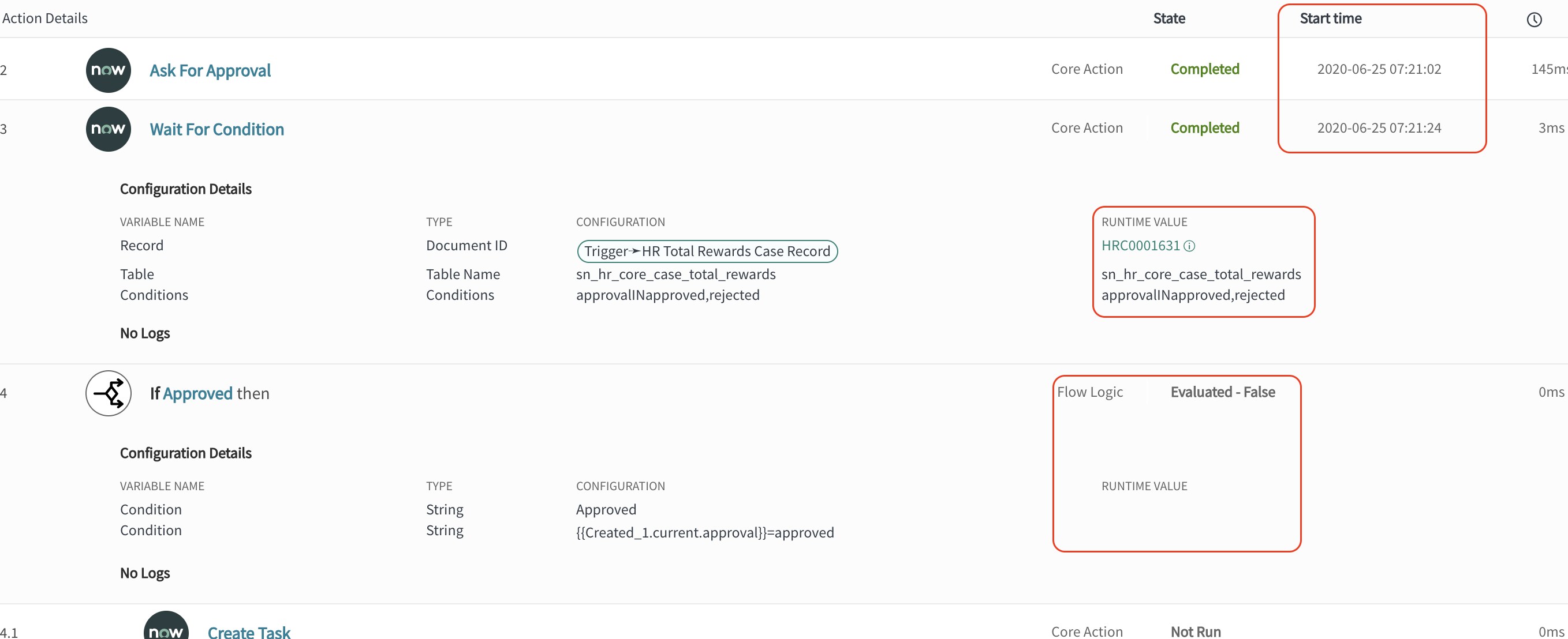

I have designed this flow and it worked perfectly before. but now, the IF condition is not working correctly. Event though the IF condition if true, it is evaluated false. Could someone help me?
The IF condition is to check if the trigger Total Rewards record is approved or not:

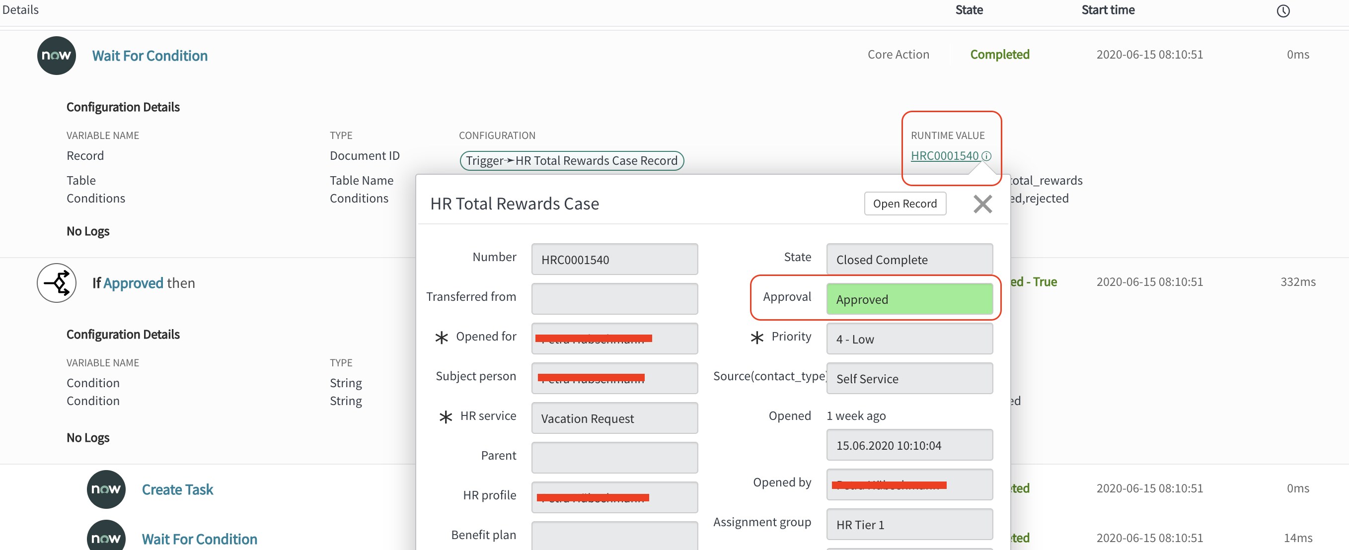

The IF condition is the is exactly the same and below was tested on 15.06.2020 and it worked.
The record is approved, which makes the IF condition = true:
Now the IF condition is evaluated to false even though it is true:
The record is approved but evaluated to FALSE 😞

Is this happening randomly?
What is the step before this if step?

Now it happens to all the time. The step before is waiting for condition, you can find it in the screenshots. This step is COMPLETED.

I think it immediately gets executed and provide a timer for 5 secs after wait for condition.
