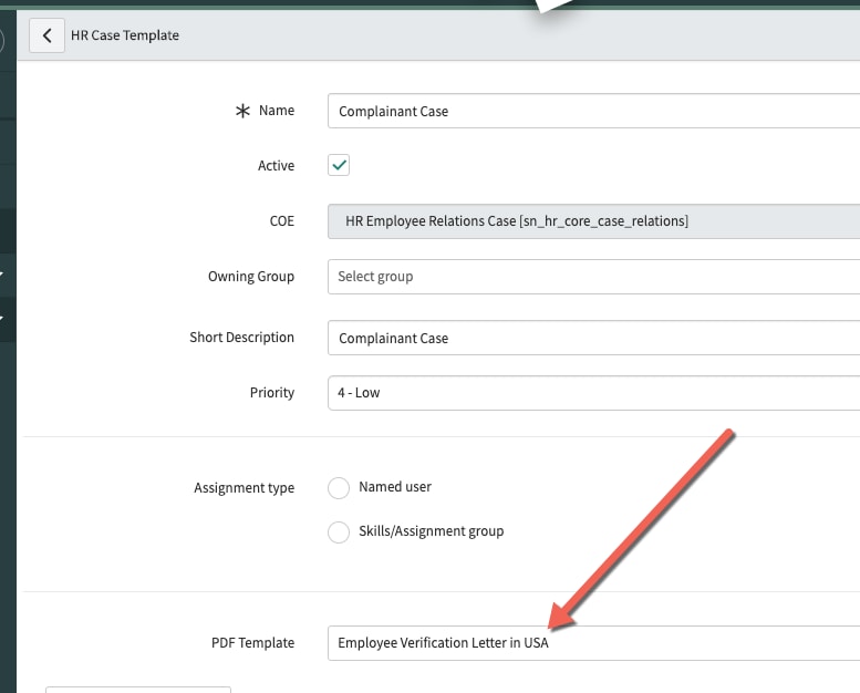

03-12-2020 12:59 PM
Hi Justin,
You can call to that template from the HR Case template (there is a PDF Template field you can add to the HR Case Template). You can have the OOB generate the document automatically using the case option on the HR Service Config, or you can manually generate it from the button on the case (once it is in Work In Progress).
03-12-2020 01:56 PM
Hi Michael,
Thank you for your response. I ended up making it that far but was still seeing an error for "PDF template cannot be found". I did some debugging and found that I wasn't sending over the right parameters to pull in the PDF template. After fixing the code, it works now.
Here is what I ended up using in the UI action:
var tableName = current.parent.sys_class_name;
var tableId = current.parent.sys_id;
var targetTableName = current.getTableName();
var targetTableId = current.getUniqueValue();
var hrForm = new GeneralHRForm(tableName, tableId, targetTableName, targetTableId).generate();
So a combination of the code above and ensuring the PDF template was on the case resolved the issue.
Appreciate your help!
Justin
