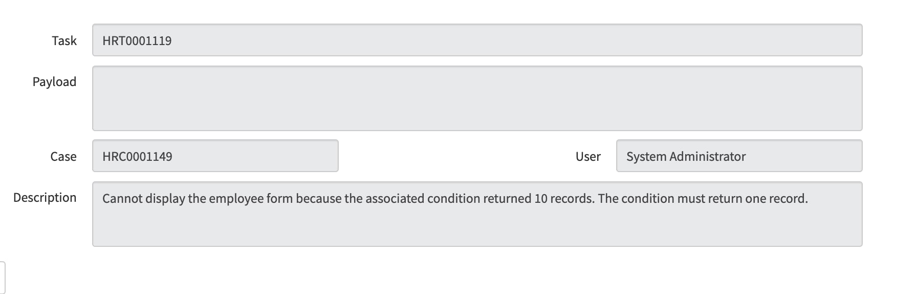

Below is my condition and I only need to return 1 value, I have this HR Case with child cases so it returned 10 records under the subject person.  Any help on what should I need to add in the condition?
Fields are not mapped and I am getting this error:

This is the OOB behavior of Employee forms , condition should always return unique value.

@jxa7987 you can use other items from the case such as the HR Service or that it is active. There are some enhancements targeted for San Diego to help with this type of use case where it is difficult to uniquely identify the case to which the data should map.

@Bec B The enhancement did not make it to the product for your use case. There are other options as I mentioned before (using the case is active and/or is a particular HR Service). There was an idea submitted for this, found here. I recommend voting to increase the visibility .
