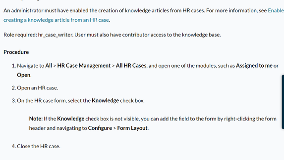

1. You can create  KB article to HR case by using following step:

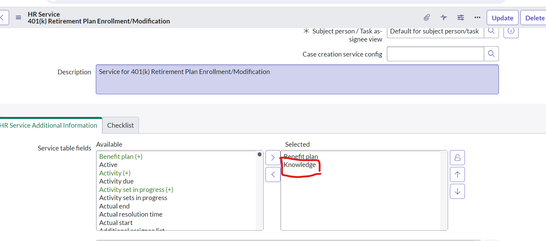

3.Add KB on HR service by using this option.
Please check this option , please mark if looks helpful and correct .

The solution which you have provided to add KB article for HR service is useful when you want to create a new KB article for the HR case if the Knowledge checkbox is checked on case form.
My question is, the way how we attach KB article directly to catalog item, same way can we attach the KB article to HR service as well?
Best Regards,
Pooja
