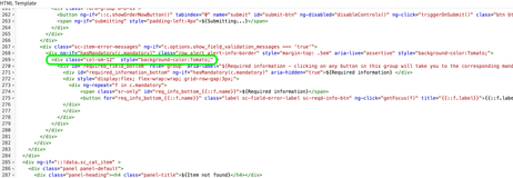

Hi @Ashir Waheed
Thank you for this information.
Would you also be able to help me how to change the background colour of that Required Information box?  Please see the image attached here.
Thank you in advance.
Hi @Mi Mi
From my understanding, I would recommend you to try the following steps
1. Ctrl+Right click on the form highlighted in given attachment.
2. Select the option "Widget in Editor"
3. In HTML Template, look for the line 269 and add the Style as mentioned in image below.
4. Define you own colors in the code according to your requirement.
5. Save and reload the portal page, this will hopefully do the thing.
I would suggest doing changes in copy widget not the OOB.
