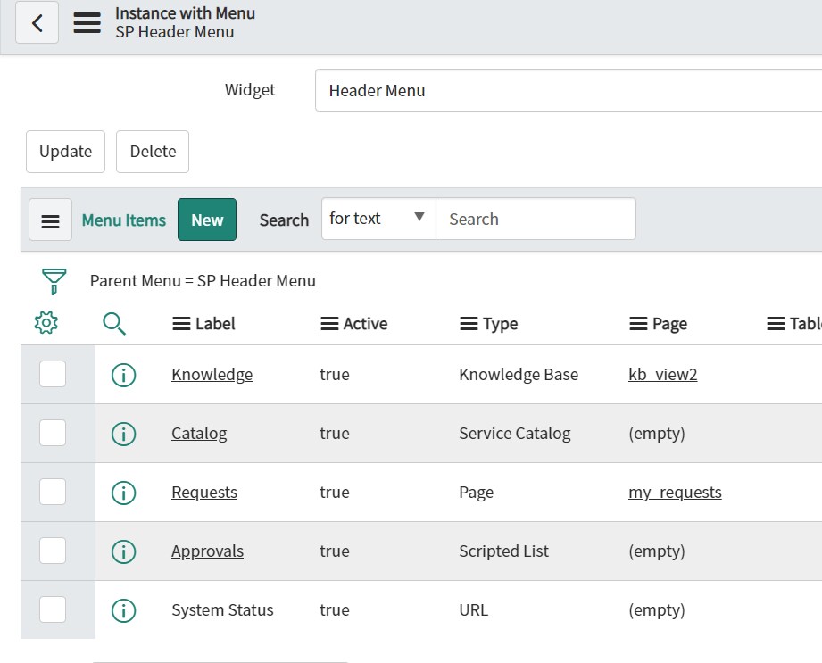

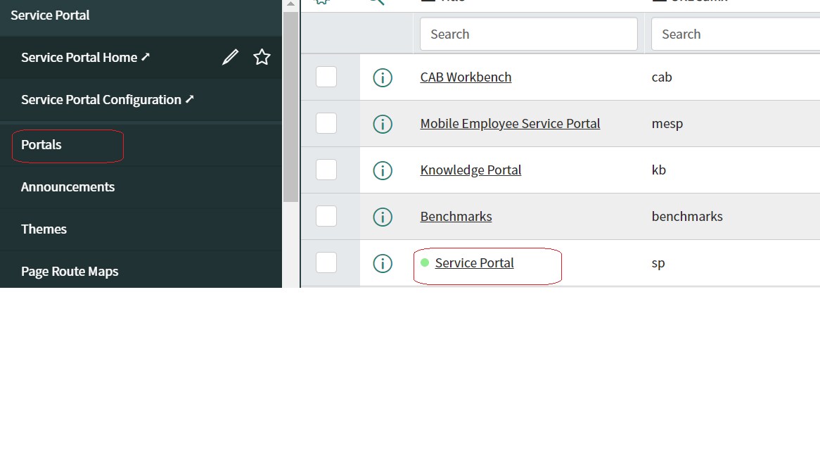

To deactivate a Head Menu please follow below steps,
1. Locate Service Portal page
2. Open Main Menu page
3. You will see Menu Items(Head Menus)
4. Make active as false.
Navigate to Service Portal --> Portals, Open your current active Service portal Page(Green dot).
2. Open Main page
3. Menu Items
Deactivate the chat.
