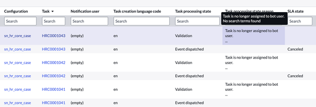

1. Navigate to System Applications -> Application Restricted caller access. Make sure all are allowed
2. Navigate to sys_cs_auto_resolution_context.LIST Check the task processing state reason. Can you share screenshots of recent records
3. Also select subject person as requester
 I changed what are suggested, still same. see record reasons below
