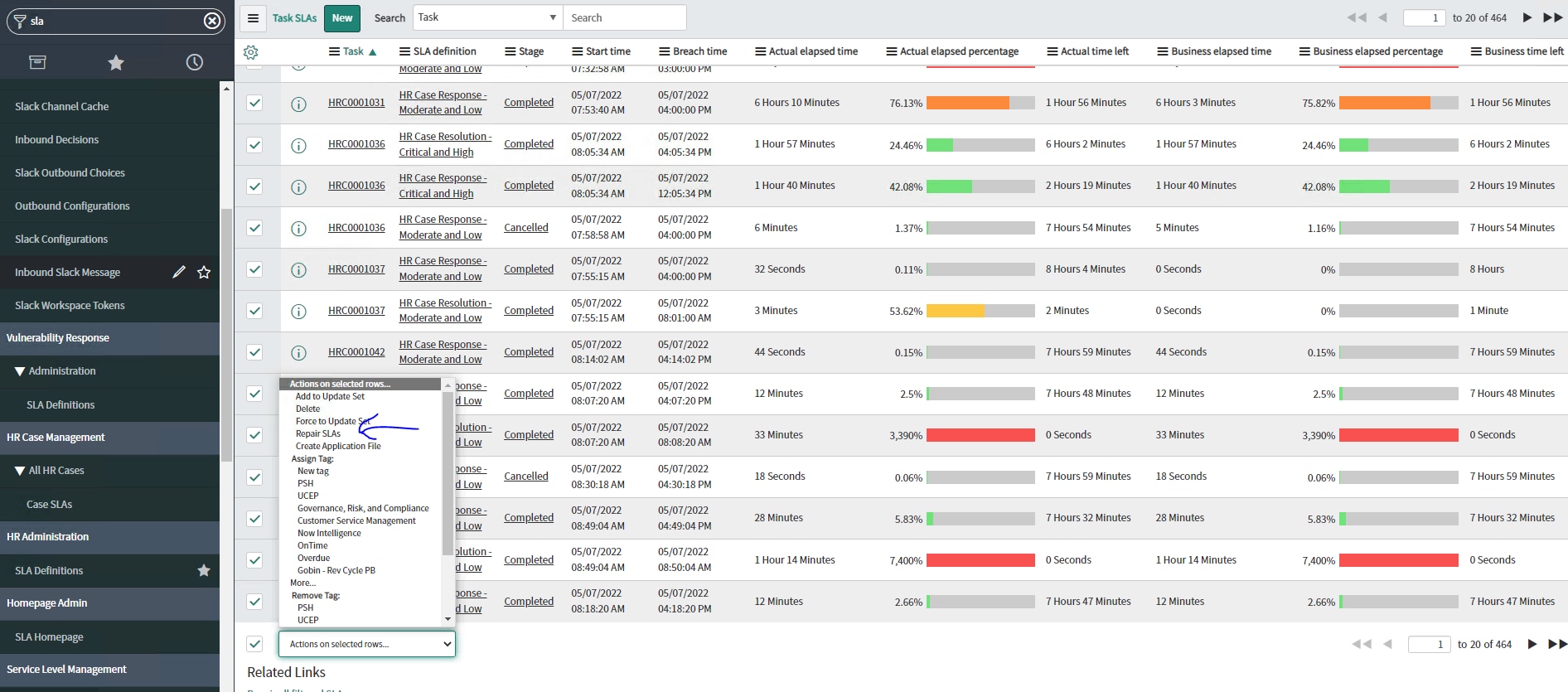

I am needing to run a "Repair SLAs" job on Task SLAs. is there a way to run this job with email/notifications going to the user?
I saw that notifications/emails were sent out from System Logs > Emails
Would this occur due to "Enable Logging" on the SLA being selected?
