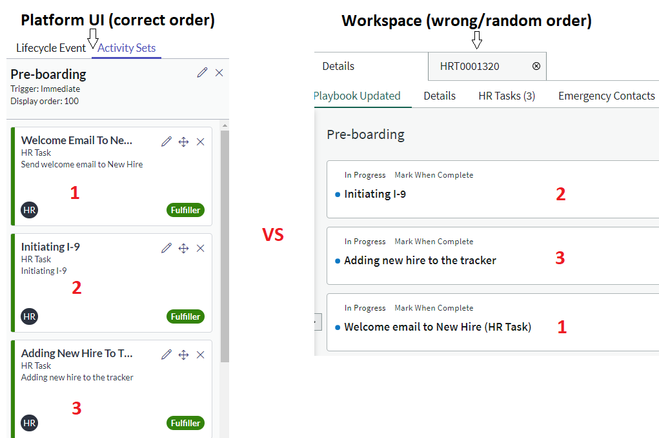

[UTAH] I created from scratch Lifecycle Event to manage some process in organization. Everything looks as expected in Manage Lifecycle Event record of Platform UI. I set up also HRSD Playbook to make my process (Lifecycle Event) available in Agent Workspace - also success here.
My goal:
I want to see Activities (Playbook cards) displayed in the Workspace Playbook in the same order I set up in Platform UI. But this is how it works based on the example of small segment from my process:
My attempts:
As you can see above display order of the activities differs between two places even if I set the order of Activities in a proper way:
Is there any other place I can set the order of Playbook cards displayed in the Workspace? Is it even possible?

We have the same complaint. Did you ever find a solution?
Unfortunately not. But even though several months have passed, I still need to solve this problem.
Also recently we moved to Configurable Workspace but even there I am not able to display Playbook cards in proper order. It's always random.
@Brad Tilton, @Chuck Tomasi if you find few seconds, would you able to help us?
