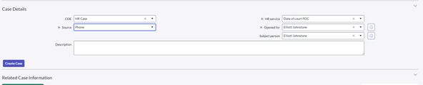

I am creating a HR Case via backend using a HR Service that is associated with a record producer that contains variables. When I create the HR Case via backend, the variables of the record producer are not visible / associated with the HR Case.
Anyone knows why and how can I fix this?

Hi @swathisarang98 ,
The backend view is:
I do realize we are creating trough HR Service and variable doesn't show in backend, but the HR Service is associated with the record producer, so in my opinion it should make the variables appear after case creation no?
Frontend view:
Hope this is enough to understand the problem.
Thanks!
