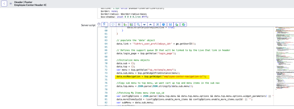

This is controlled in the Employee Center Navigation widget, so you'd need to:
- Clone that widget
- Comment/remove code to display that level
- Update the header widget (e.g., Employee Center Header) from your portal to call your cloned widget instead of employee-center-navigation. This should be in the server script of the header widget.
- The header widget is found on the Theme of your portal record.
- If you don't already have a cloned header widget, clone that too, so you are not updating the OOB version. Then update your portal record to use your cloned header.
