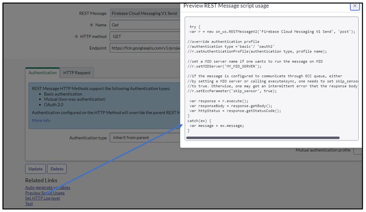

I  created a REST message for the GET call and tested it with mutual authentication. Mutual authentication is working fine.
I created Flow, Subflow, and action.  In that action, I am trying with REST step. But REST Step does not support mutual authentication.  (It only supports inline or connection alias)Has anybody implemented REST step or script step with mutual authentication?   I have to execute the REST GET method and parse it (JSON)

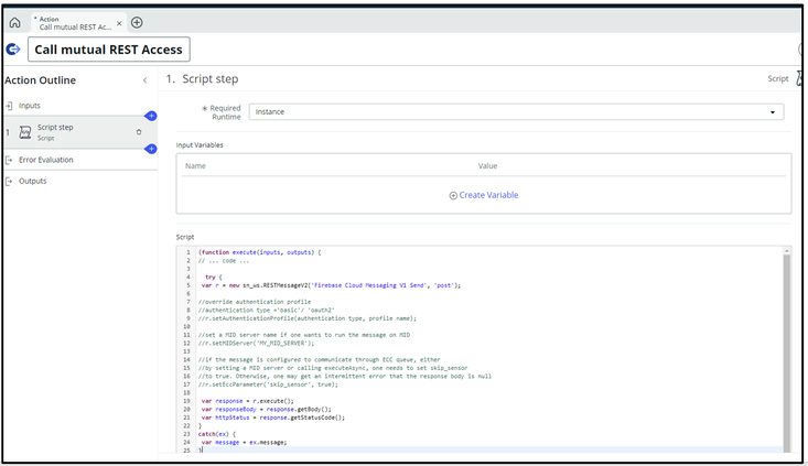

You can use Script steps of Flow action following steps below:
step 1- Copy script from REST message
Step 2 - Create Flow action and then add "Script Steps".  Paste the pre-copied script (step 1) into Script section blow and make proper changes

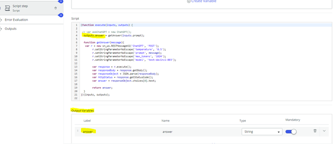

Thanks for your response. Can I use JSON parser step as the next step? HOW to send values (payload)into output.
Ra
You can use JSON parser (see my code blow).  You can define output variable to hold your returned payload.
