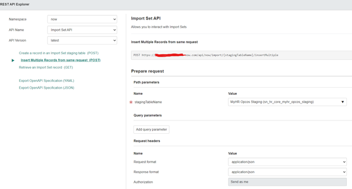

Hello.
I am testing the insert multiple records on the Rest API Explorer module.
with this body
"records":[
{"u_code":"1","u_external_id":"1","u_opco_name":"test"},
{"u_code":"2","u_external_id":"2","u_opco_name":"test2"},
{"u_code":"3","u_external_id":"3","u_opco_name":"test3"},
{"u_code":"4","u_external_id":"4","u_opco_name":"test4"},
{"u_code":"5","u_external_id":"5","u_opco_name":"test5"},
{"u_code":"6","u_external_id":"6","u_opco_name":"test6"},
{"u_code":"7","u_external_id":"7","u_opco_name":"test7"}
And it is working well:

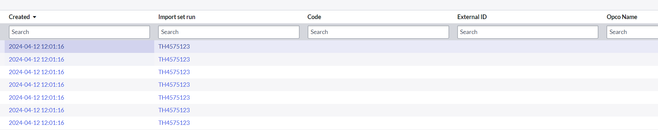

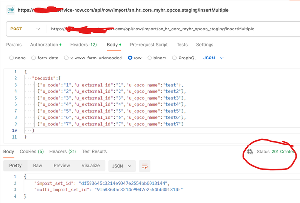

But when I try the same thing on postman... it inserts empty fields on my staging table
Can someone help me please?

Hi @Andr_1 ,
I tried your problem on postman as you mentioned, it works for me, may be you can check Business rules may be there is setAbortAction is present in your instance at the time of insertion. SO what's why it is not inserting the records.

By default, the keys are set to use column labels rather than column names. To resolve this, try switching to column labels and test again.
The request body format should match the staging table's columns. Use the records array with key-value pairs that align with the staging table's column labels to ensure proper insertion into the import fields.
If you need to modify the mapping settings, you can add an entry in the REST Insert Multiple (sys_rest_insert_multiple) table and change the Column mapping from Label to Column Name.
09-11-2024 12:25 AM
Hi @ash1xh , I did as your replay. Its worked. Thanks a lot
