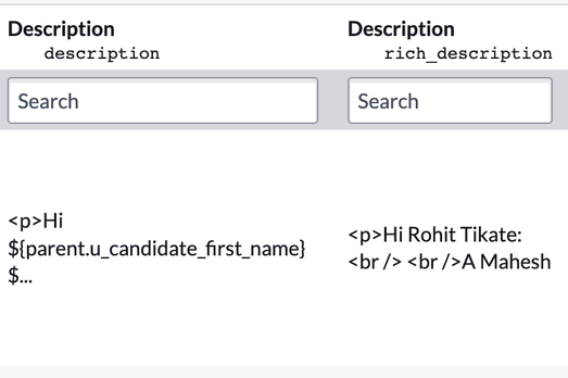

 There are two Description fields on HR task table i.e (Type : String & HTML)
Bring Description (rich_description) field on the form through Form layout or Form Designer.
You can check the field value through list view as well.Screenshot 2023-08-26 at 8.23.36 AM.png

Hello @Suzanne H
Mark my answer correct if this helps you...
Thanks @Community Alums, adding the rich description field to the form worked. What do you mean by saying You can check the field value through list view as well.?
if you don't want to bring that field on form then you can personalize list and bring that field to list.
To check whether it is giving value or not.
