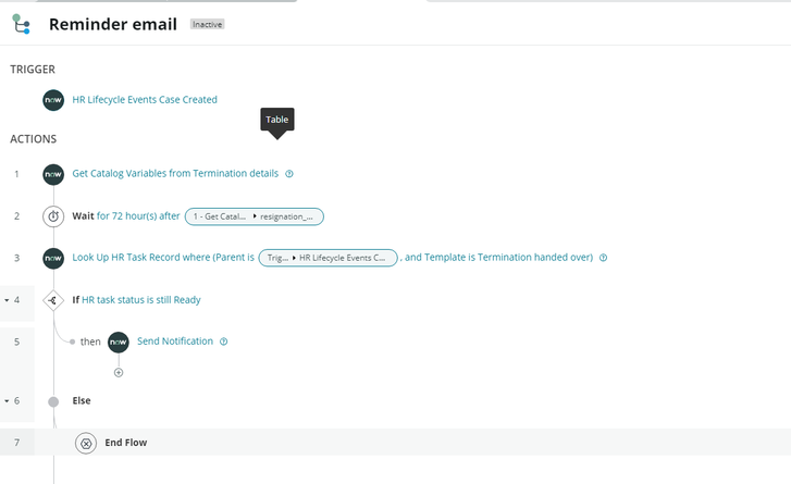

@cwillard  You can achieve this requirement using flow designer without scripting.
 If your flow trigger is based on the parent case creation then build flow as below

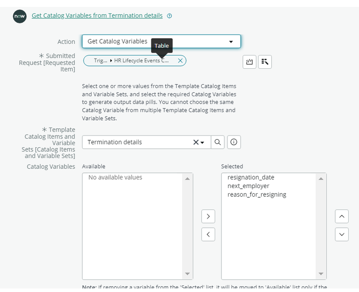

Steps 1 : Get catalog variables from record producer which is associated with you Parent HR case Service

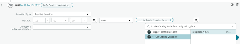

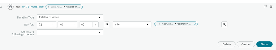

Step2 :-  User "Wait for duration of time" flow logic to hold the flow for 72 hours after employee last working day

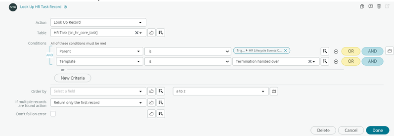

Step3 :- Look up for HR Task record which is associated with Parent case

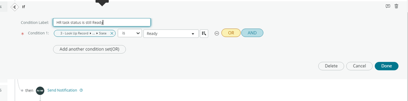

Step 4 - Check if Task status is still Ready and send the notification

Thank you so much for this detailed response! It worked perfectly!
