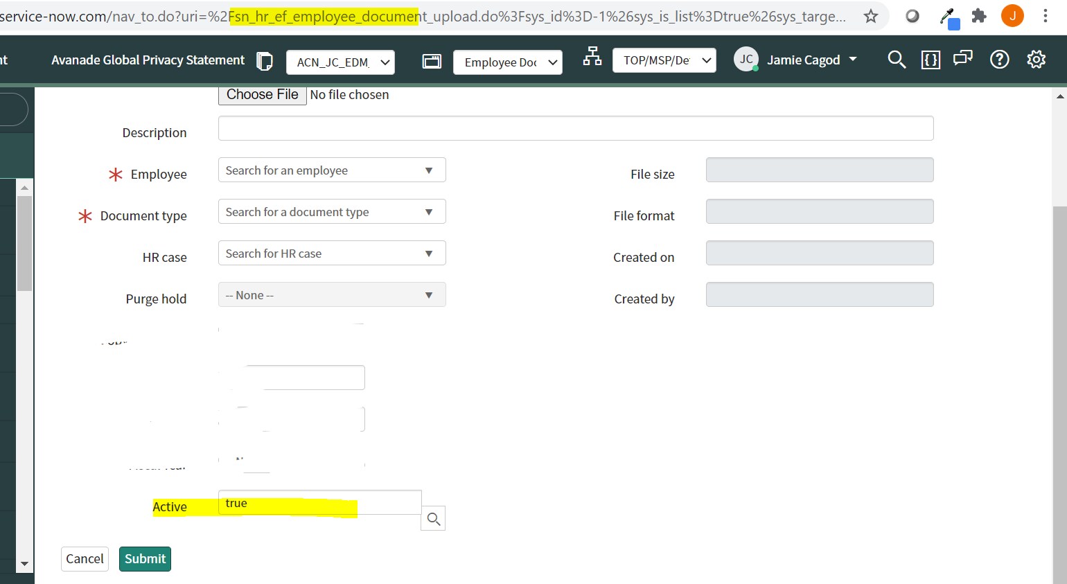

So we did some modifications in "employee_document_upload" UI Page, and we added "Active" field on the form.
What I'm trying to do is to set the Default value of Active = true. Because on the Employee document table, this field default is set to true - but when submitting it is was set to false.
I tried:
1. <g:ui_reference name="active" value="${jvar_active}" displayvalue="true" table="sn_hr_ef_employee_document"/> (fig1) - its setting the default, but when submitting - it was still Active = false, and I don't want to use reference field.
2. input type="text" readonly="true" class="col-md-12 form-control" ng-model="active" id="active" displayvalue="true"/> (does not the set default or display value)
3. using g:evaluate, no luck - not sure how to use this.

fig.1)

09-29-2020 12:44 PM
I don't have this issue, when the form is submitted it defaults to active.
Have you checked the sn_hr_ef_employee_document table to ensure the default value for active is true?
The actual record creation process is just done through a http.put method through the table API.
However, the UI Page does explicitly set the document to active
If these OOB configurations are present, it would be worth validating you don't have any 'insert' business rule running.

09-29-2020 03:38 PM
Hi Keiran,
Thank you! the data.active = true in your screenshot was actually the reason why it was inactive. I have actually added another data.active on the script when I updated the UI page.
Thanks again!
