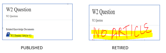

ISSUE :- Related knowledge article on HR Service Form/record Producer(HR PORTAL) does not work properly for end-users if the knowledge article is updated/retired.
It works fine for admins but for end users(no knowledge roles) it does not. Screenshots below.
1. If updated and Published with a new version - System does not show the article short description but just the icon. Screenshot attached below.
2. If Retired - System still shows the article even if it is retired.
Updated Article Screenshot (Version V2)
Portal View (Admin vs End User)
  Article name is missing for end-user.
SOLUTION:-
Linking Between KB Articles and Record Producer/Catalog Items is handled in table  "Catalog Item to KB Links [sc_2_kb]".
Create an after(insert/Update) Business rule on Knowledge [kb_knowledge] table with appropriate filters. E.g. workflow is Published/retired and update the record in sc_2_kb table with the updated version of of the KB article or delete the record if the article is retired.
It works fine for End user in both the cases Published and Retired.
Here is the simple code:-
                var gr= new GlideRecord('sc_2_kb');
                gr.addQuery('kb_knowledge.number',current.number);
                gr.query();
                if(gr.next()){
                                if(current.workflow_state=='published'){
                                                gr.setValue('kb_knowledge',current.sys_id);
                                                gr.update();
                                if(current.workflow_state=='retired'){
                                                gr.deleteRecord();
})(current, previous);
