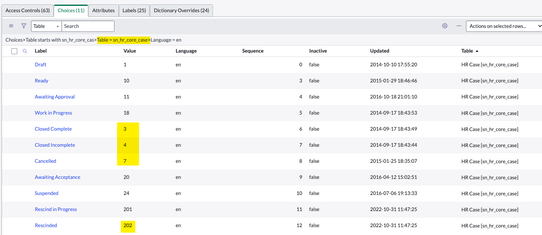

The HR Case state values that are considered inactive are at the dictionary override level for the HR Case table.
Task.state dictionary choices, filtered by HR Case table, so you can get the Value to set on the override attributes:

- From the "Choices" related list/tab, verify the Value of the Transferred state label on the case table.
- If you followed leading practices and consistency, it will be a numeric value (e.g., 😎

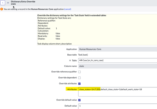

- Select the "Dictionary Overrides" related list
- Validate if you already have a record for the sn_hr_er_case table.
- If so, open it
- If not, open the one on sn_hr_core_case. Update the table from sn_hr_core_case to sn_hr_er_case and do an Insert & Stay. Do NOT update the existing sn_hr_core_case record
- Update the "Attributes" field on the dictionary override for sn_hr_er_case to be:
- close_states=3;4;7;202;<XX>,default_close_state=3,default_work_state=18
- Replacing <XX> with the numeric value of your Transferred state. Pay attention to the formatting. It's semi-colons between the list of states to be considered closed/inactive, and a comma between the different attributes
- Save the record & test
