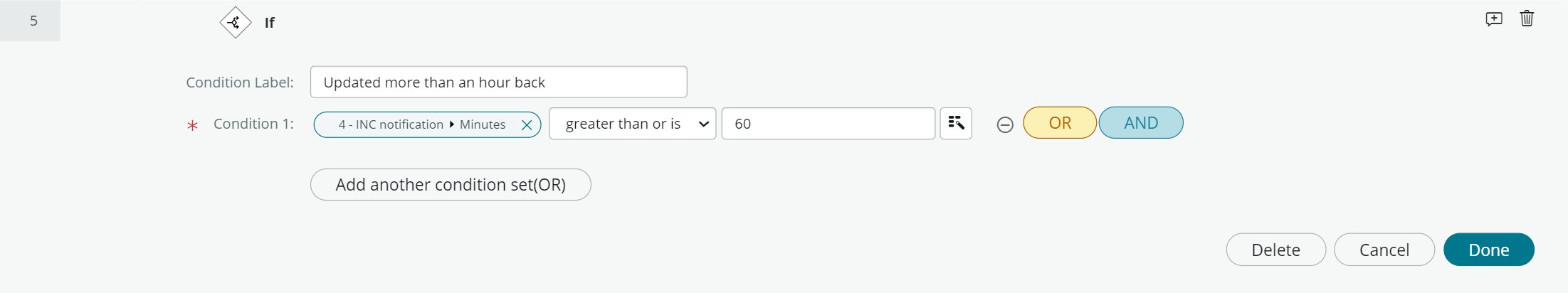

2-D: Check if the time difference is more than 1 hour
2-E: If the update is more than 1 hour, send an email to assigned to user manager.

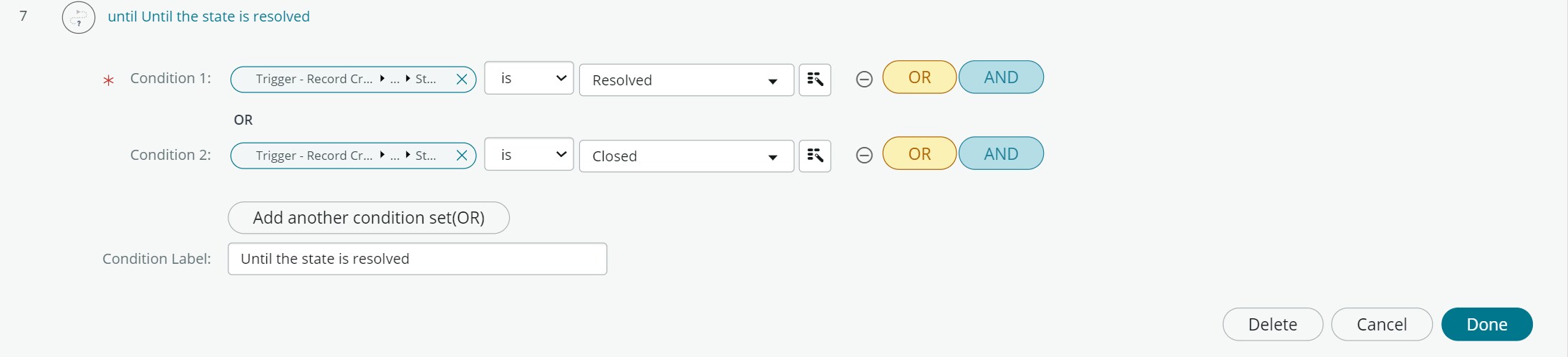

2-G: If the incident is resolved, get out of the loop and end the flow.
