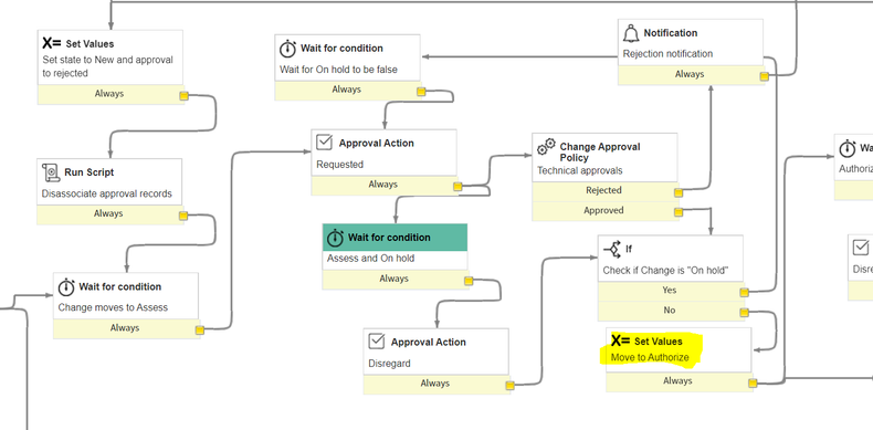

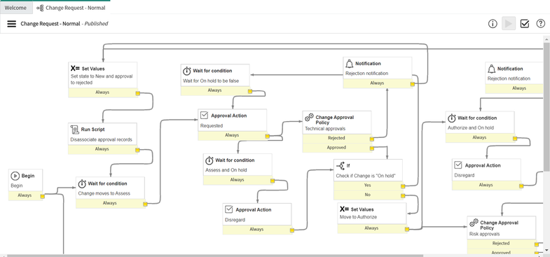

Normal Change Request process is automated using "Change Request - Normal" Workflow as below:
You just need to modify this workflow and add your required Approvals activities before "Set Value" activity which set state to 'Authorize' as highlighted below:
NOTE: To make changes you need to first checkout the workflow, make required changes and than again Publish it to make it work.
