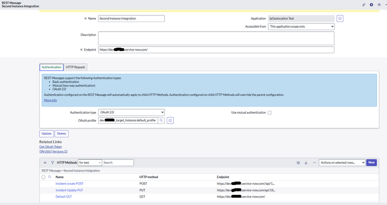

Hello @Ankur Bawiskar ,
Please find the screenshots to find what i actually did and this is what i need.
Everything works fine i build only one thing it is creating an incident in the target instance but the short description and description is blank.I am also successfully fetching the output with the incident number everything is fine just this bit i am guessing some thing i am doing wrong while sending the request body.
flow_desgner_output.pngflow_designer_inputs.pngflow_designer_json_builder.pngflow_designer_json_parser.pngflow_designer_rest_step.png
Can you please guide what is wrong here why its is not setting the short_description and description in target instance.

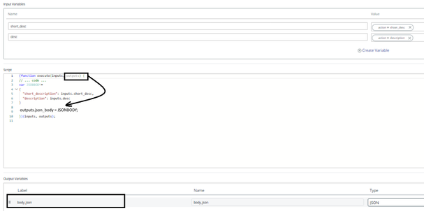

Hello @Debasis Pati ,
I think while passing request body the outputs param is not used and you declare output variable below so the JSONBODY needs to be passed in outputs parm.
