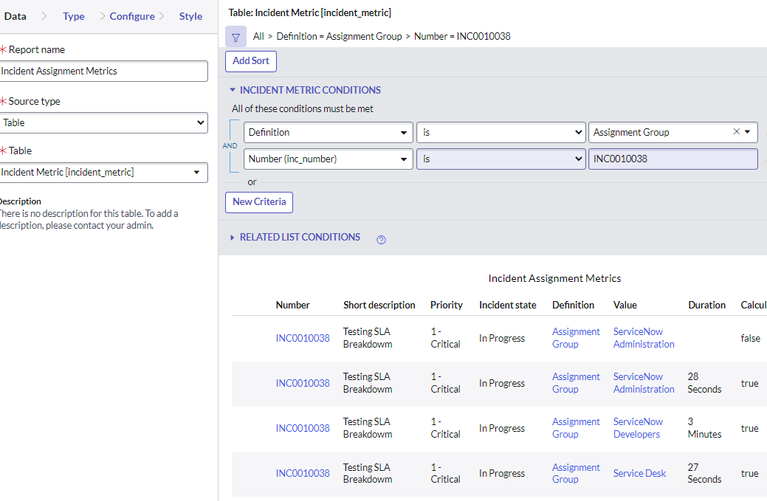

Dear Experts,
Is there any use case that could help us to calculate time that is spent across all the assignment group to which an incident is assigned. We tried using Database Views but that is only calculating the entire time slot. Please help ! it is urgent.

But how do we build a report on that?   That's where some OOB database views come in handy.  You can build a report on a table called "Incident Metrics" which is a dbview linking Incidents, Metric Definitions, and Metric Instances.   Here's a report I built looking ONLY for metric_instances with a definition of Assignment Group and an incident number of a specific one I use for testing.
