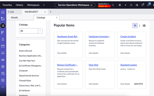

I have one more requirement like, I have a change request record producer, once I click on create change request from incident forom on SOW it should open record producer on sow itself, can you please help me with this how to achieve it
Hello @khaliqzy ,
You can use the OOB Behaviour for this.
Click 'Create Request' button
You will be navigated to the Catalogs form, you can add you record producer the associated category, (if already not present)
Najmuddin
